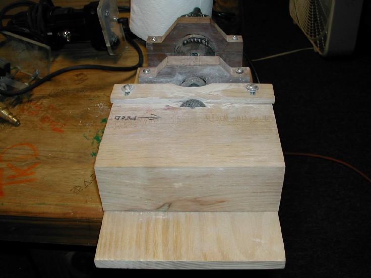

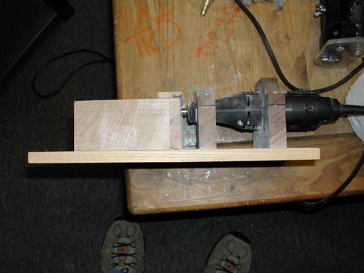

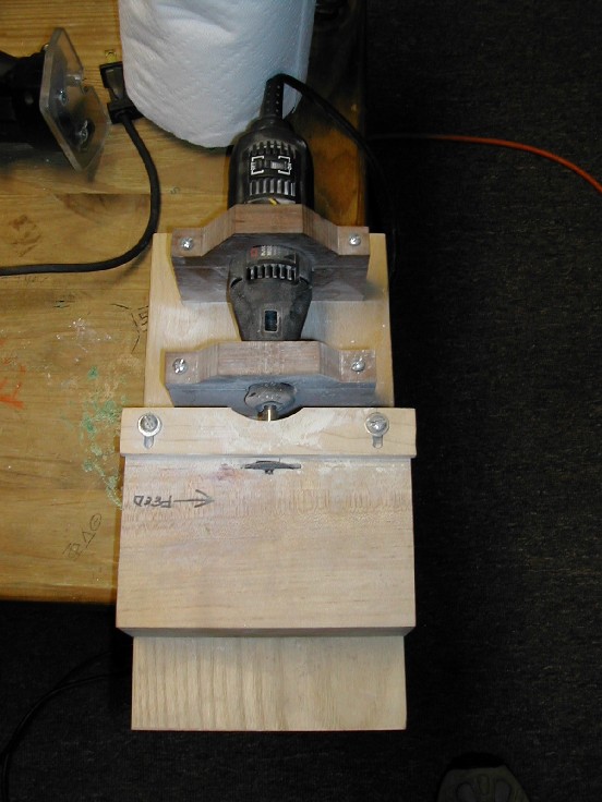

Here are some pics from Amy Hopkins class at ASIA last June. I've never made this jig, but it looks very useful. Enjoy!

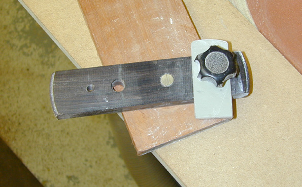

I dont have a pic handy, but I use a 5 inch fine grinding wheel to create the inside curve, then mark and cut by jewelers saw the outer curve rough, and oversize a bit. I then made a rotating vise that holds the shell piece in a little slot that is also cut at a five inch diamter, and clamp the base of this on the table of my sanding wheel, then simple adjust to teh right arc and sand each piece - i can make enough for a rosette in 15-20 minutes. Whats nice is I can use any shell type, and make virtually any width I want. The 5 inch inner diameter will work with almost any rosette pattern/size you will encounter. If I need smaller, say for a 3.5 inch soundhole, I sand the shells inner edge on a 4 inch drum/sandpaper first, and have a different arc setting for the clamp to sand the outer edge.

jsut took the pic this morning - here it is. Notice I have used both ends, one gives the std 5 inch radius to the inner curve of the shell, the other is 4 inch. Using a circle cutter jig I routed the ledge that the shell sits in - about 40 thou deep to hold 50 thou thick shell. The wood is afr blkwood, so it holds a thread well, the clamp bar is a pc of aluminum with a couple small pieces of veneer CAd on at each end - they allow the alum to sit just above the blkwood, and give the screw some ability to apply pressure on the shell piece. SImply clamp up to the sanding disc, set for whatever width of shell you are after and pivot/sand away.
